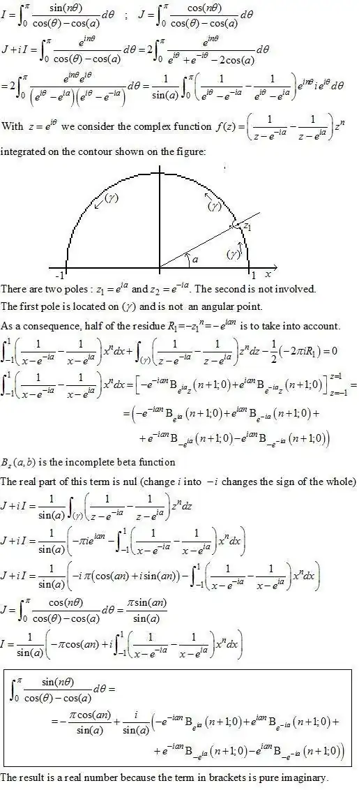

Thanks to complex analysis, it is rather easy to obtain $$ \int_0^{\pi}{\cos\left(n\theta\right)\over \cos\left(\theta\right) - \cos\left(\alpha\right)}\,{\rm d}\theta=\frac{\pi cos(n\alpha)}{sin(\alpha)} $$ By the way, this result is also obtained in attachment, but with a method much more complicated than usual. In fact, this complicated method is proposed for the much more difficult integral :
$$ \int_0^{\pi}{\sin\left(n\theta\right)\over \cos\left(\theta\right) - \cos\left(\alpha\right)}\,{\rm d}\theta\ $$ The closed form obtained involves the Incomplete Beta function in the complex range. Nevertheless, one of the parameters is nul, which makes think that further simplification might be possible (may be involving polylogarithms)
Several numerical checking were done. Of course, for the numerical computation of the integral (noted $I$ in attachement), the Cauchy principal value is considered.
