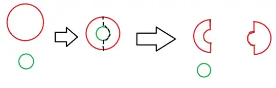

We have two circular cakes of the same height but unknown and potentially different radii, and we want to cut them into two equal shares. Each cut can only cut one piece of one cake. What is the minimal number of cuts required?
The solution is easily found:
It's $1$ cut. Stack the two cakes and center them, then cut the big one around the small one : enter image description here Here you go.

    Initial results: The largest cake must always be cut into $p$ pieces, so $p-1$ is a lower bound. Otherwise, there don't seem to be any answers as elegant as the $p = 2, n = 2$ case. I've made a few drawings. – Paul Z Jun 26 '14 at 19:26

    What sorts of cake-cutting tools and techniques are allowed? I wouldn't have realized that we could properly align the centers of the cakes, or that we could properly return to the original line of a cut after taking a detour around another cake, and it may not be clear to everyone that putting a cake on top of another cake results in two neatly stacked cakes instead of an awful mess. Do we have rulers? Compass and straightedge? Can we measure or duplicate angles in some fashion? – user2357112 Jun 26 '14 at 20:30
  • @user2357112 i edited it, is that better ? – Hippalectryon Jun 26 '14 at 20:32

  • The 'easy solution' for a basic problem seems a bit unclear. How do you know / make sure the smaller cake is centered atop the bigger one? How do you know / make sure the straight cuts are collinear and would meet the (invisible) center if extended under the smaller cake? (Actually, the cakes needn't be centered if you make the straight parts of the cut along the line passing through centers of both stacked cakes.) – CiaPan Sep 12 '23 at 11:42
