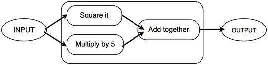

But in other equations -- even fairly simple ones -- have a different kind of structure. For example, $x^2+5x=10$ looks like this:
Notice that this structure resists any attempt to solve it by "unwinding", precisely because of the fork in the diagram. The $x$ flows through more than one path, which makes it impossible to trace the result backwards to its source.

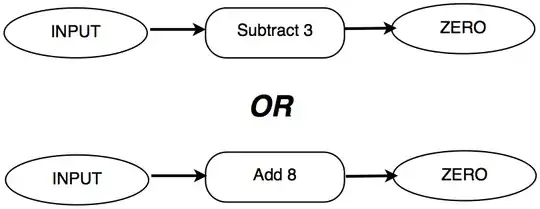

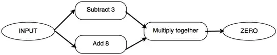

Of course, this is not the only method that can be used to tackle quadratics. Consider the slightly different example of $x^2 + 5x = 24$. If we rearrange this as $x^2 + 5x - 24 = 0$ and factor the LHS, we get $(x-3)(x+8)=0$. This equation can be diagrammed as follows:
At first glance this looks to be no better than the original equation; it has a fork in it, and seems resistant to unwinding. But! There is this property of real numbers, the "zero product property", which says that if two numbers multiply to be zero, then one of them must be zero. And that allows you to split the diagram into two separate diagrammatic cases:
And each of those can be tackled via a very simple unwinding method.
