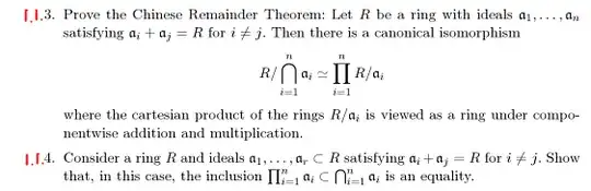

Here is the problem:
and the two problems it refers to:
Scanning through the book, the author uses $j(R)$ to refer to the Jacobson radical and $rad(R)$ for nilradicals, so the OP's interpretation is accurate according to the text.
