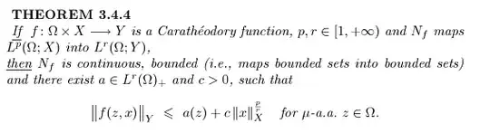

However we can use this theorem from here
where $N_f(u)(z) = f(z,u(z))$.
Define $f\colon [0,T] \times L^2(\Omega) \to L^2(\Omega)$ by $f(t, u) = g(u)$. $f$ is Caratheodory since $g$ is continuous. Define $N_f(u)(t) = f(t,u(t)) = g(u(t))$. If $u \in L^2(0,T;L^2)$ then $$|N_f(u)(t)|^2 = |g(u(t))|^2 \leq C|u(t)|^2$$ which is in $L^2(\Omega)$. So $N_f(u) \in L^2(0,T;L^2)$. Therefore the theorem applies and $N_f$ is continuous. So if $u_n \to u$ in $L^2(0,T;L^2)$ then $g(u_n) \to g(u)$ in $L^2(0,T;L^2)$.

Yes, applying the textbook theorem about the continuity of a more general Nemytskii operator solves the problem stated in the first paragraph.
That said, the proof of continuity in 3.4.4. is much like the proof you could give directly for your problem. The idea of picking a subsequence that converges a.e. is good. And you are right: we don't have a dominating function for the Dominated Convergence Theorem. So, use the Generalized DCT instead.
