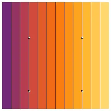

Anyway, here's an animation where two points have $z=0$ and two have $z=1$. They initially form a square, and then the top edge rotates about its midpoint.
