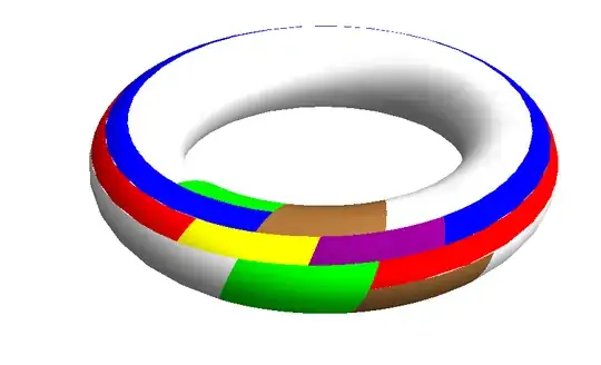

Apparently, that code for 7-coloring a torus from Wagon's book that I was speaking of in the comments is a bit old; here's an update for newer versions of Mathematica:
spiral[theta0_, theta1_, phi0_, phi1_, color_] :=
 ParametricPlot3D[{
  (4 + Cos[1/143 (144 phi + 12 theta)]) Cos[1/143 (12 phi + 144 theta)],
  (4 + Cos[1/143 (144 phi + 12 theta)]) Sin[1/143 (12 phi + 144 theta)],
   Sin[1/143 (144 phi + 12 theta)]},
     {theta, theta0, theta1}, {phi, phi0, phi1},
  Mesh -> False, PlotStyle -> color]
Show[
     spiral[Pi/12, (21*Pi)/12, Pi/3, 2*Pi, White],
     spiral[-((3*Pi)/12), -(Pi/12), Pi/2, (13*Pi)/6, Green],
     spiral[-(Pi/12), Pi/12, Pi/3, 2*Pi, Brown],
     spiral[-(Pi/6), 0, Pi/6, Pi/3, Yellow],
     spiral[Pi/6, (23*Pi)/12, Pi/6, Pi/3, Blue],
     spiral[0, Pi/6, Pi/6, Pi/3, Purple],
     spiral[Pi/12, (11*Pi)/6, 0, Pi/6, Red],
   Axes -> None, Boxed -> False, Lighting -> "Neutral",
   PlotRange -> All, ViewPoint -> {2, 0.2, 1.2}]
7-colored torus map
