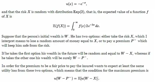

After solving this we reached the following,
So,only need help to solve the last step.

The utility function is $u(x) = -e^{-x}$ which is concave. The person is risk averse and will pay the premium to avoid loss. The loss has an exponential distribution with expectation
$$E[X] = \int_{0}^{\infty}2xe^{-2x}dx = \frac{1}{2}.$$ The premium is determined by
$$u(W-P^-)=E[u(W-X)] .$$ Substituting the utility function
$$-e^{-(W-P^-)}= \int_{0}^{\infty}[-e^{-(W-x)}]2e^{-2x}dx = -e^{-W}\int_{0}^{\infty}2e^{-x}dx=-2e^{-W}$$
Hence,
$$e^{P^-}=2\\\ P^- = \ln(2) $$
So the premium is $\ln(2)$ which is slightly larger than the expected loss.
