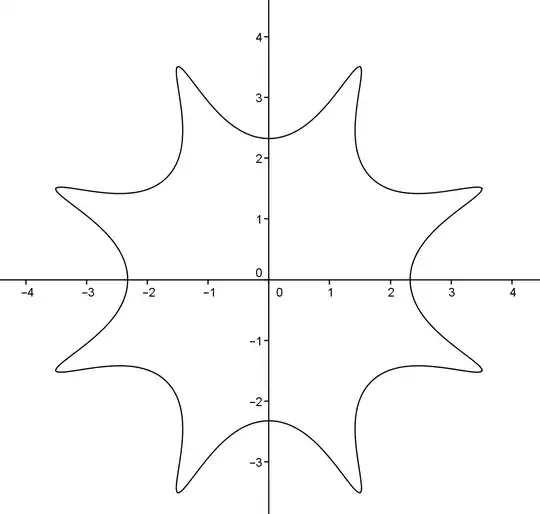

$\qquad\qquad\qquad\quad$ The above shape is given by the implicit polynomial equation $$A\Big(x^8+y^8\Big)+B\Big(x^6y^2+x^2y^6\Big)+C~x^4y^4=R^8,$$ where $A=0.3$, $B=-3.3$, $C=10$, and $R=2$. Letting $x=r\sin t$ and $y=r\cos t$, we are finally able to express it in polar coordinates, since the Cartesian ones seem somewhat inadequate, given its extremely concave shape, which render it quite resistant to being parsed in terms of single-value functions, despite various sectionings and rotations. Thus the afore-mentioned integral is born. But whether it possesses a closed form, even one in terms of special functions, such as elliptic integrals, is beyond me. I don't really see the tangent half-angle substitution going anywhere. Perhaps some complex integration methods are in order ?

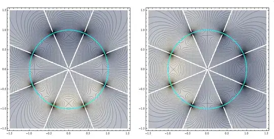

For the reasoning behind my choice of contour, see this picture. The $16$ roots are located at the tips of the white lines with the white lines being the branch cuts. Due to aforementioned simplification, the final integral is equal to the sum of the integrals along the white lines in the unit circle. Symmetry can be used to simplify the final evaluation.
Here is the code used to generate this image (stolen from this post).
GraphicsRow[Table[ContourPlot[g[f],{x,-1.5,1.5},{y,-1.5,1.5},ColorFunction->"GrayYellowTones",Epilog->{Cyan,Thick,Circle[{0,0}],Red,PointSize[0.02],Point[{Re@#,Im@#}&/@{}]},Contours->100],{g,{Re,Im}}]]
