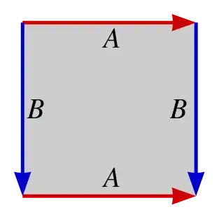

You can view $S^1\times S^1$ as a torus which can be represented by a rectangle with opposite edges identified with the same orientation (see below).
$\hspace{4.5cm}$enter image description here

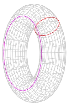

Now $S^1\vee S^1$, the wedge sum of two circles, is precisely the boundary of this rectangle (the four corners are identified with a single point which is the point where the two circles are joined). This may be clearer to see on the torus itself (see below).
$\hspace{5.8cm}$enter image description here
So $(S^1\times S^1)/(S^1\vee S^1)$ is the rectangle where we identify the entire boundary with a single point; this is one way to view the two dimensional sphere, as the one-point compactification of $\mathbb{R}^2$.
  • So one copy of $S^1$ (in the wedge sum) is the top and bottom edges of the rectangle, and the other copy of $S^1$ is the left and right edges? – Cordelia May 26 '14 at 05:53
  • That's correct. The images I just included may help to see what's going on. – Michael Albanese May 26 '14 at 05:56
  • Thanks Michael, I understand now. Out of curiosity, I was trying to look at the torus as in your second picture. If we quotient the red circle to a point, it seems like we'd get an earring shaped thing. I couldn't picture a way to then quotient the purple circle to a point, but maybe this is just not the right way to think about it. – Cordelia May 26 '14 at 06:01
    @Cordelia You get an earring-shaped thing, and perhaps you should think of collapsing the purple circle as making the "earring hole" smaller and smaller until it's gone. (I think it's better to visualize with the purple circle as the center circle.) –  May 28 '14 at 14:59
