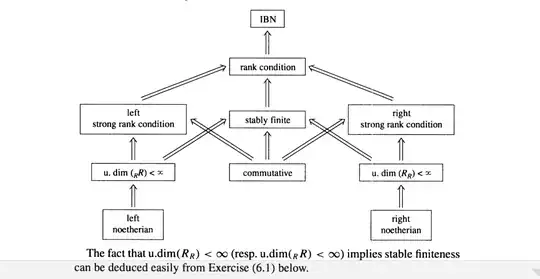

Invariant basis number and many related properties are studied in section 1.§1 of Lam's Lectures on modules and rings, they are summarized in this diagram on page 17 in which none of the implications can be reversed:
Implications between IBN and other properties
The example showing that invariant basis number does not imply the rank condition is as follows (it appears on page 11 after proposition 1.24:
Let $R$ be the $\mathbb{Q}$-algebra with generators $a,b,c,d$ and relations $$ ac=1, \quad bd=1, \quad ad = 0 = bc $$ so that we have $$ \begin{bmatrix} a \\ b \end{bmatrix} \begin{bmatrix} c & d \end{bmatrix} = \begin{bmatrix} 1 & 0 \\ 0 & 1 \end{bmatrix}. $$ This shows that $\begin{bmatrix} a \\ b\end{bmatrix}: R \to R^2$ is an epimorphism so that the rank condition fails.
The proof that $R$ does have invariant basis number is given in P.M. Cohn, Some remarks on the invariant basis property, Topology 5 (1966), 215–228, MR197511.
Cohn denotes this ring by $U_{1,2}$ in §5. The proof that it has invariant basis number involves deriving a normal form for elements of $R$ and showing that the trace of $1 \in R$ (i.e., the image of $1$ in the abelian group $R/[R,R]$) has infinite order. It is a bit too laborious for me to reproduce it here. The argument is given before Lemma 5.1. By the Corollary in §3 (or Lam's Exercise 5 on page 17) this implies that $R$ has invariant basis number.
