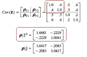

I know what is inverse (-1) of a matrix but I do not have any idea how to compute this P^{-1/2}.

4. Test with the Example given
$$ A = 1, \quad B = 0.4, \quad C = 0.4, \quad D = 1 $$
we get (rounded to 5 digits) for the matrix roots:
$$ \tau = 2, \quad \delta = 0.84 \\ s = \pm 0.91652, \quad t \in \{\pm 1.9578, \pm 0.40862 \} \\ M^{1/2} \in \left\{ \pm \left( \begin{array}{cc} 0.97891 & 0.20431 \\ 0.20431 & 0.97891 \end{array} \right), \pm \left( \begin{array}{cc} 0.20431 & 0.97891 \\ 0.97891 & 0.20431 \end{array} \right) \right\} $$
and for the inverse matrix roots:
$$ \delta' \in \{ 0.91652, -0.91652 \} \\ M^{-1/2} \in \left\{ \pm\left( \begin{array}{cc} 1.06807 & -0.22292 \\ -0.22292 & 1.06807 \end{array} \right), \pm\left( \begin{array}{cc} -0.22292 & 1.06807 \\ 1.06807 & -0.22292 \end{array} \right) \right\} $$
That first positive one is the one from your example. Testing a bit:
$$ (M_1^{-1/2})^2 = \left( \begin{array}{cc} 1.06807 & -0.22292 \\ -0.22292 & 1.06807 \end{array} \right)^2 = \left( \begin{array}{cc} 1.19048 & -0.47619 \\ -0.47619 & 1.19048 \end{array} \right) \\ M^{-1} = \left( \begin{array}{cc} 1.19048 & -0.47619 \\ -0.47619 & 1.19048 \end{array} \right) $$ which seems fine.
