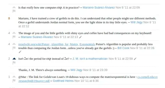

Here are the comments from November, 2011, visible in order: enter image description here
