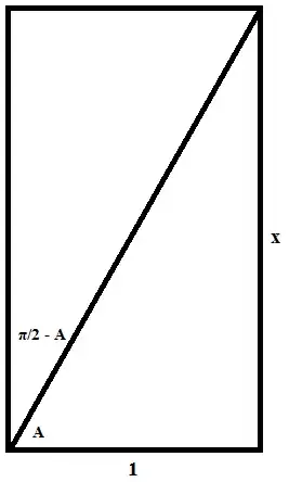

Sometimes drawing a diagram is helpful.
From the diagram it is clear that $$\tan A = x$$ $$A = \arctan(x)$$ and that also $$\tan(\pi/2 - A) = 1/x$$ $$\arctan(\tan(\pi/2 - A)) = \arctan(1/x)$$ $$\pi/2 - A = \arctan(1/x)$$ $$\pi/2 - \arctan(x) = \arctan(1/x)$$ or alternatively, $$\pi/2 - \arctan(1/x) = \arctan(x)$$
