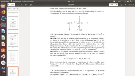

I'm stuck on implication $1) \to 2) $

What happens if you tensor the short exact sequence $$0\to I\to R\to R/I\to 0$$ with $I$?
I'll put in the picture because I could not write the diagram in latexenter image description here
