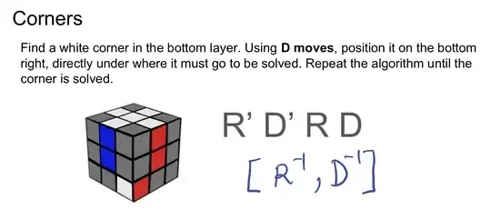

  • White corners: Repeat ${ [R ^{-1}, D ^{-1}] }$

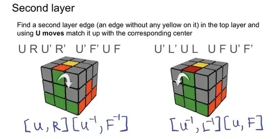

  • Middle layer: ${ [U, R] [U ^{-1}, F ^{-1}] }$ and ${ [U ^{-1}, L ^{-1}][U, F] }$

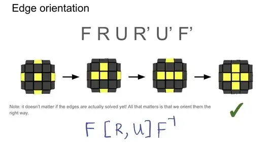

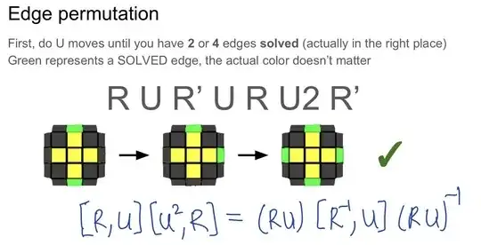

  • Yellow edge pieces: ${ F [R, U] F ^{-1} }$ till yellow cross, then ${ (RU) [R ^{-1}, U] (RU) ^{-1} }$ till yellow edges align

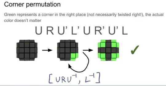

  • Yellow corner permutation: Repeat ${ [U R U ^{-1}, L ^{-1}] }$

Edit: Page 4 of Daniel Bump's notes here explains the importance of commutators, and how for example ${ [U R U ^{-1}, L ^{-1}] }$ moves very few pieces in the cube. (Intuitively, because the supports of ${ U R U ^{-1} }$ and ${ L ^{-1} }$ overlap very little). The full course page is here.
