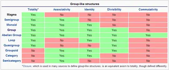

    A magma could have associativity, or an identity, etc. It is just not required to have those properties. For example, every group is a magma. – bradhd May 03 '14 at 12:13

  • @Brad Yes. I've seen in the wikipedia link, it seems to be the most basic structure: One adds the other properties and then one gets the other algebraic structures. But I'm curious specifically about one without associativity, identity, divisibility and comutativity. – Red Banana May 03 '14 at 12:18

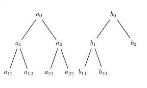

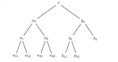

As other people have pointed before you should pay attention to definition of magmas: it doesn't require that operation satisfies any property (associativity, existance of identity,etc) but it doesn't require either that the operations have to satisfy non associativity or non identity properties.
Anyway here's an example of magma which doesn't satisfy associativity (nor existance of identity).
Let $X$ be the set of finite planar binary trees. Given two trees $a$ and $b$ then we can form the tree $a \cdot b$ obtained from the union of the two trees adding a new root.
This operation is well illustrated by the following images: it should take two trees such as The two trees $a$ and $b$
and return a tree such as the following one enter image description here
This is of course a binary operation and non associativity can be proven by drawing some trees. Non existance of identity follow from the fact that whatever trees you compose via this operation the composed tree has a depth strictly greater than both input trees.
Hope this helps.
