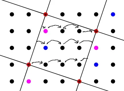

In Quotient ring of Gaussian integers it was shown that for $a,b$ coprime the quotient is actually isomorphic to $\mathbb Z / (a^2+b^2)$, but in general, it is still true that they have the same size.
If you look at the picture enter image description here
taken from the answer Quotient ring of Gaussian integers by quanta in the above-mentioned thread, you see that we want to count the lattice points in the square spanned by $a+bi$ and $-b+ai$.
As the points on the border have to be partially identified, it turns out we want to count interior points plus half the border points -1. (Since opposite sides of the square are identified, we want to count only half the border points, but we want to count only 1 of the 4 corners, so we have to subtract one.)
This gives exactly the area $\left(\sqrt{a^2+b^2}\right)^2=a^2+b^2$ of the square by Pick's theorem.

  • This is really a nice way to look at it geometrically. Thanks for introducing me to Pick's theorem. – yunone Oct 30 '11 at 02:42

  • @yunone: Probably the best way to see that is to look at the figure in Phira's answer. The length of the diagonal of the square is $d=\sqrt{2(a^2+b^2)}$. And you also see that any point on the plane (in particular any point on the grid) is at a distance at most $d/2$ from one of the corners (=red dots). So if you need to "divide" a gaussian integer $w=u+iv$ by $a+bi$, then you locate the red dot closest to $w$. That is of the form $q(a+bi)$ for some gaussian integer $q$. Let $r$ be the separation vector. Then you have $w=q(a+bi)+r$, and $|r|\le d/2=\sqrt{(a^2+b^2)/2}$. – Jyrki Lahtonen Oct 30 '11 at 10:12
  • Thanks @Jyrki. I didn't expect so much geometry to come into play. – yunone Oct 30 '11 at 10:31
