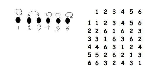

I have already tried with $S_3$, and indeed, the product is $(13)$, and $(13)^2=e$
But what about this: I define + in this way:$45=2$,$26=3$, $1$ is the identity. therefore, $123456=2326=233=3$, and as you can see from the picture, the inverse of $3$ is not itself, thus contradicts the statement. My question:
What is wrong with my argument?
And How do you prove the statement?
it seems that my set of numbers perfectly forms a group under the operation I defined via the table above. first it's closed, second there is an identity, third every elements have an inverse. By the way it's commutitive. I tried (45)2=22=6=42=4(52), (45)6=26=3=43=4(56), so associativity seems to be satisfied.

What you have defined is not a group.
Hint for your problem: Pair each $a_i$ that you can with its inverse, and multiply to get $1$. Which $a_i$ are left in your product?
Zarrax
  • 46,591
  • Thank you sir. Why is it not group please? I already tried what you said before, but what I concluded was that the product is some element in the group, and its inverse needs not be itself. – pxc3110 Apr 25 '14 at 02:57
  • you have to define all possible products... and you have to make sure they satisfy associativity, commutativity (for an abelian group) and so on. So the products you have given can't be extended to all possible products in such a way that you get an abelian group. – Zarrax Apr 25 '14 at 02:59
