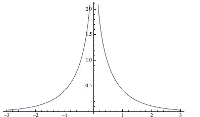

With $\ds{x \equiv A\expo{\theta/2}\,,\quad A > 0\,,\quad\theta \in {\mathbb R}}$: \begin{align} {\rm P}\pars{\xi}&={1 \over \pi\sigma^{2}} \int_{-\infty}^{\infty} \exp\pars{-\,{1 \over 2\sigma^{2}} \bracks{A^{2}\expo{\theta} + {\xi^{2} \over A^{2}}\expo{-\theta}}}\, \pars{A\expo{\theta/2}\,\dd\theta/2 \over A\expo{\theta/2}} \end{align} We can choose $\ds{A}$ such that $\ds{A^{2} = {\xi^{2} \over A^{2}}\quad\imp\quad A = \verts{\xi}^{1/2}}$: \begin{align} {\rm P}\pars{\xi}&={1 \over 2\pi\sigma^{2}} \int_{-\infty}^{\infty} \exp\pars{-\,{\verts{\xi} \over \sigma^{2}}\cosh\pars{\theta}}\,\dd\theta ={1 \over \pi\sigma^{2}} \int_{0}^{\infty} \exp\pars{-\,{\verts{\xi} \over \sigma^{2}}\cosh\pars{\theta}}\,\dd\theta \end{align}
$$\color{#00f}{\large% {\rm P}\pars{\xi} = {1 \over \pi\sigma^{2}}\, {\rm K}_{0}\pars{\verts{\xi} \over \phantom{2}\sigma^{2}}} $$ where $\ds{{\rm K}_{\nu}\pars{z}}$ is a Second Kind Bessel Function.
