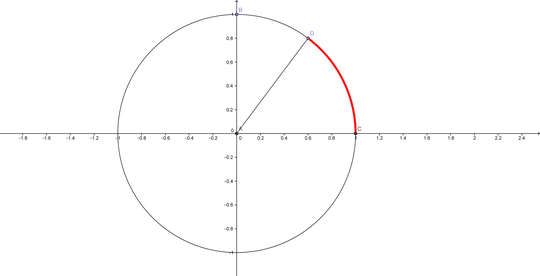

Define the unit circle to be the locus $x^2+y^2=1$.
Define $(\cos \theta,\sin \theta)$ to be the point at arc-length $\theta$ from the point $(1,0)$ on the unit circle (measuring counter-clockwise). Circle
So the red segment has length $\theta$ units.
Then we define $(\cos\theta,\sin\theta)$ to be the x- and y-coordinates of the point $D$. Since $D$ is on the unit circle, it immediately follows that $x^2+y^2=\cos^2\theta+\sin^2\theta=1$. It can also be shown geometrically that $$\sin(a+b)=\sin a\cos b+\sin b\cos a$$ From this all other standard identities can be easily derived, and the derivatives of $\sin x$ and $\cos x$ may be proved.
Note: the number $\pi$ can be defined as half the circumference of the unit circle. Then an angle of $2\pi$ radians goes around the whole circle exactly once. From the derivatives mentioned above and this definition of $\pi$ (which implies that $\sin^{-1}(1)=\pi/2$, among other things) we can use some rules of integration to show that $$\text{area of unit circle}=2\int_{-1}^1{\sqrt{1-x^2}\,\mathrm{d}x}=\pi$$
It is important for you to realize that Spivak's are not the original definitions of $\sin x$ and $\cos x$. They are theorems, originally proved based on the definitions given above (also note: the "unit circle" definition and the "right triangle" definition are easily shown to be the same), and now turned into definitions with the "definition" becoming a "theorem."
The reason for using this unusual approach is to simplify algebraic derivations and proofs which would otherwise be more challenging, and to streamline the process of building up the basic facts regarding trigonometric theorems. Whether this is "better" or "worse" is for you to decide, but the straightforward (albeit slightly more tedious) approach given in this post has always been more intuitive and appealing to me.
