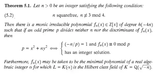

Statement 2: The more general case goes as follows.

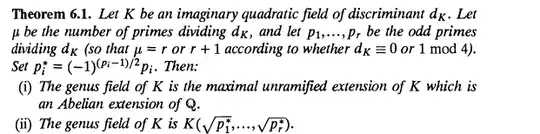

Statement 3: Finding the HCF for $K=\mathbb{Q}(\sqrt{-n})$ is difficult. However, when $n$ is one of Euler's 65 convenient numbers then the Hilbert class field of $K$ equals the genus field of $K$. The genus field can be easily determined as follows:

  • Construct a primitive element for the genus field (cf. here)
  • Next, from the minimal polynomial of the Hilbert class field, I want to recover congruence conditions through quadratic reciprocity.
Two worked out examples:
  1. The genus field of $K=\mathbb{Q}(\sqrt{-5})$ is $M=K(\sqrt{5})=K(i)$. Now, the Hilbert class field equals the genus field, so the minimal polynomial for the primitive element $i$ is $x^2 + 1$. From the above theorem we get the condition that $$x^2 + 1 \equiv 0 \mod{p}$$ must be solvable. But this just means that $-1$ is a quadratic residue modulo $p$. Together with the other condition of the theorem, which says that $-5$ is a quadratic residue modulo $p$, we find that: $$p = x^2 + 5y^2 \Leftrightarrow p \equiv 1,9 \mod{20}$$
  2. The genus field of $K=\mathbb{Q}(\sqrt{-21})$ is $M=K(\sqrt{-3},\sqrt{-7})$. To calculate the minimal polynomial for the primitive element $\sqrt{-3} + \sqrt{-7}$, we use Wolfram: $$f(x)=x^4+20x^2+16=(x^2+10)^2-84$$ This polynomial is solvable modulo $p$ if $$y^2 \equiv 84 \mod{p}$$ is solvable, AND $$x^2 \equiv - 10 \mod{p}$$ has a solution. Each condition can, via quadratic reciprocity, be expressed by a congruence, and putting the different congruences together (via the AND operator) gives us again a congruence condition.
