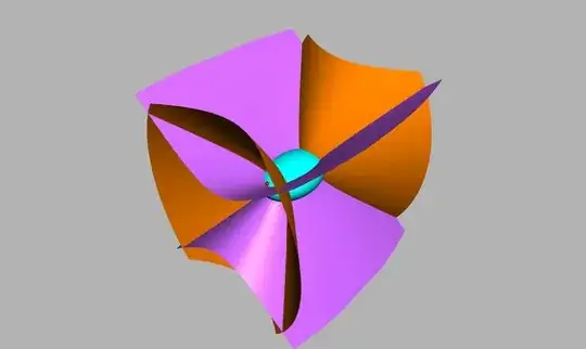

Confocal Quadric coordinates have been of real importance for the ellipsoid. A typical situation is given in the example, the umbilic points are as in the reference above.
$$ \frac{x^2}{4} + \frac{y^2}{2} + \frac{z^2}{1} = 1 $$
$$ \frac{x^2}{4-\lambda} + \frac{y^2}{2-\lambda} + \frac{z^2}{1-\lambda} = 1 $$
$$ \frac{x^2}{4-\mu} + \frac{y^2}{2-\mu} + \frac{z^2}{1-\mu} = 1 $$
Here $\lambda$ and $\mu$ are given by: $ 4 > \mu > 2 > \lambda > 1 $ ( In the picture $\lambda = 1.5$ and $ \mu = 3$ ).
See: http://mathworld.wolfram.com/ConfocalEllipsoidalCoordinates.html
