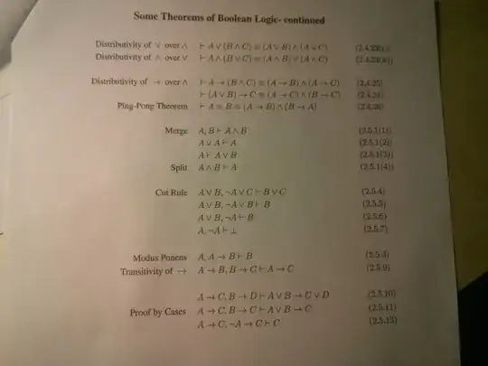

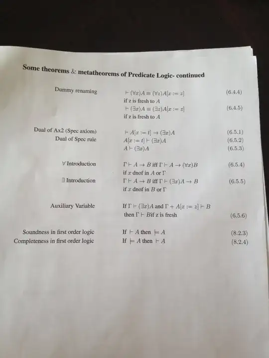

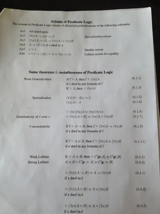

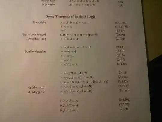

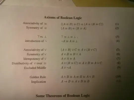

Lists of axioms and theorems.
enter image description here enter image description here enter image description here enter image description here enter image description here
