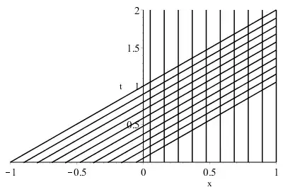

Here is a sketch of the characteristic curves in the $x$-$t$ plane, which equation is given by $$ \begin{aligned} x'(t) &= u(x(t),t) \\ &= u(x(0),0) \end{aligned} $$ Those curves intersect already at time zero:
Thus, a shock wave arises.

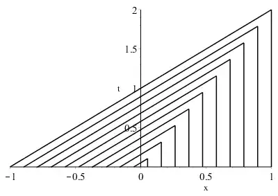

The Burgers' equation is rewritten in the conservative form $u_t + f(u)_x = 0$, where $f(u) = \frac{1}{2}u^2$. The shock wave with speed $s$, left state $u_L = 1$ and right state $u_R = 0$ writes $$ u(x,t) = \left\lbrace \begin{aligned} &1 &&\text{if}\quad x<st \\ &0 &&\text{if}\quad st<x \, . \end{aligned} \right. $$ The speed of shock must satisfy the Rankine-Hugoniot condition $s = \frac{f(u_R) - f(u_L)}{u_R - u_L}$, i.e. $s = \frac{1}{2}$. Here is a modified sketch of the $x$-$t$ plane, which accounts for the shock:
