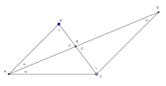

Let's not get into formal proofs. I don't think that is what you or your instructor are talking about.
The picture above can be used to prove that the angle bisctor at $A$ intersects side $\overline{BC}$ in such a way that $\dfrac{AB}{BE} = \dfrac{AC}{CE}$. The proof involves showing that $\triangle AEC \sim \triangle DEB$ and showing that $\triangle ABD$ is isoscelese.
The proof is clever yet very straightforward and there is a big problem with it. The proof assumes that the ray $\overrightarrow{AD}$ intersects the interior of side $\overline{BC}$ at point $E$. Just because it is so very obvious does not mean that it is true.
Proofs using pictures are like that. They make some things so obvious that the presenter does not bother justifying them. Students almost by definition do not have the experience necessary to get away with this.
