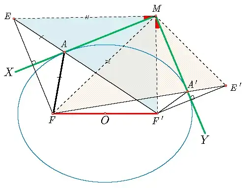

I will provide a geometric proof.
Consider an Ellipse of foci $F$ and $F'$. Let $M$ be a point outside the ellipse. The tangents from $M$ touch the Ellipse at $A$ and $A'$. Let $E$ be the symmetric of $F$ with respect to $MA$ and define $E'$ similarly.
${\bf Step 1.}$ The points $F'$, $A$ and $E$ are aligned. Indeed, by the optical property of the ellipse $\angle MAF'=\angle FAX=\angle XAE$. Similarly, the $F$, $A'$ and $F'$ are also aligned.
${\bf Step 2.}$ $\triangle FE'M$ and $\triangle F'EM$ are congruent. Because, $EF'=EA+AF'=FA+AF'=2a$ and similarly, $FE'=2a$. Moreover, $ME=MF$ and $ME'=MF'$.
${\bf Step 3.}$ $\angle AMA'=\angle F'ME$. Indeed, from the previous step we conclude that $$\angle XME=\frac{1}{2}\angle EMF=\frac{1}{2}\angle E'MF'=\angle YMF'.$$
${\bf Step 4.}$ It follows that $MA\bot MA'$ if and only if $\angle EMF'=\frac{\pi}{2}$, and (since $EM=FM$,) this equivalent to $$FM^2+F'M^2=F'E^2=4a^2\tag{1}$$ But using the parallelogram identity we know that $$ FM^2+F'M^2=2OM^2+2OF^2=2OM^2+2c^2 $$ Thus, $(1)$ is equivalent to $OM^2=a^2+b^2$, which is the desired conclusion.
