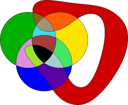

I espy why the IEP and the last line (after the red lozenge) are true for $m \le 3$ sets, thanks to pictures like this one on page 2 of 7. Yet I don't perceive it when $m \ge 4$ (which I don't think can be visualised) ? Whence does this expression originate?

You are right saying that no similar picture can be made with discs. However a set can be given any shape. Here's an example with four sets. Intersections of four sets
  • $A$ green
  • $B$ blue
  • $C$ yellow
  • $D$ red
  • $A\cap B$ pink
  • $A\cap C$ cyan
  • $A\cap D$ dark brown
  • $B\cap C$ light green
  • $B\cap D$ violet
  • $C\cap D$ orange
  • $A\cap B\cap C$ red brown in the middle
  • $A\cap B\cap D$ bright green
  • $A\cap C\cap D$ light brown
  • $B\cap C\cap D$ pale blue
  • $A\cap B\cap C\cap D$ black
