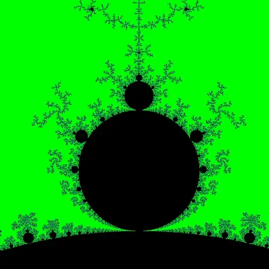

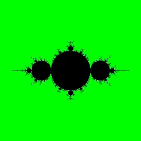

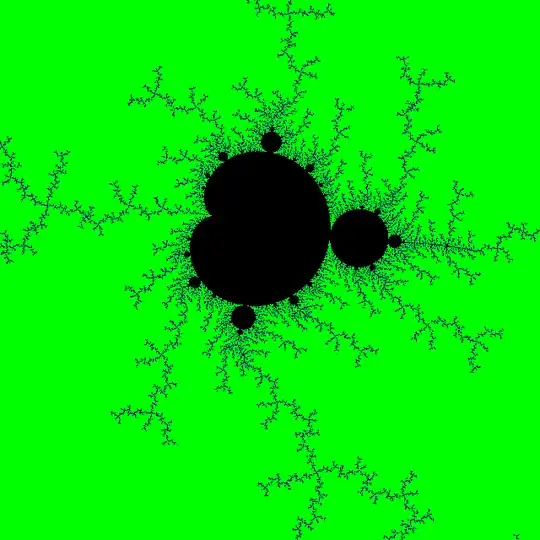

Iterating the cubic polynomial, $z \mapsto c(z^3-3z)$, starting with z=1, one gets a cubic mandelbrot, whose "mini-mandelbrots" are conjugate to the quadratic mini-mandelbrots. These images are from Wolf Jung's Mandelbrot program, under cubic polynomials with semi-conjugate to quadratic.
cubic mandelbrot, iterating as above zoom upper middle zoomed in on mini-mandelbrot in cubic mandelbrot

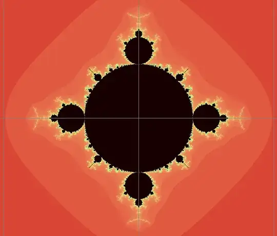

Here is one more example, iterating $z \mapsto c(z^5-5z)$, starting with z=1, which also has mini-mandelbrots. quintic mandelbrot, iterating c(z^5-5z)
