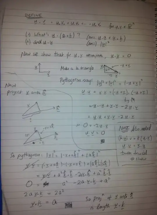

I finally got a derivation from scratch:
This addressed a hole in my understanding -- I had never enquired as to what motivates the definition of the dot operator.
As far as I can see, we just go ahead and define it, then show that it behaves nicely with algebraic manipulations. Then we show, using Pythagoras, that u, v perpendicular gives: $\mathbf u \cdot \mathbf v = 0$.
Finally we use all previous results to get the projection result.
I'm not typing it up at the moment as RSI is paining me; if somebody would care to do it then I am grateful! (what would be a good way of making the diagrams?)
