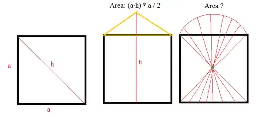

This is an idea I have had in my head for years and years and I would like to know the answer, and also I would like to know if it's somehow relevant to anything or useless. I describe my thoughts with the following image:
What would the area of the "red almost half circle" on top of the third square be, assuming you rotate the hypotenuse of a square around it's center limiting its movement so it cannot pass through the bottom of the square.
My guess would be:
$$\ \frac{\left(\pi*(h/2)^2 - a^2\right)}{2}$$
And also, does this have any meaning? Have I been wandering around thinking about complete nonsense for so many years?

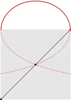

I found this problem interesting enough to make a little animation along the line of @Blue's diagram (but I didn't want to edit their answer without permission):
Mathematica syntax for those who are interested:

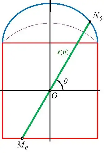

Let $O$ be the center of the square, and let $\ell(\theta)$ be the line through $O$ that makes an angle $\theta$ with the horizontal line. The line $\ell(\theta)$ intersects with the lower side of the square at a point $M_\theta$, with $OM_\theta=\dfrac{a}{2\sin \theta }$. So, if $N_\theta$ is the other end of our 'rotating' diagonal then we have $$ON_\theta=\rho(\theta)=h-OM_\theta=a\sqrt{2}-\dfrac{a}{2\sin \theta }.$$ Now, the area traced by $ON_\theta$ as $\theta$ varies between $\pi/4$ and $3\pi/4$ is our desired area augmented by the area of the quarter of the square. So, the desired area is $$\eqalign{ \mathcal{A}&=\frac{1}{2}\int_{\pi/4}^{3\pi/4}\rho^2(\theta)\,d\theta-\frac{a^2}{4}\cr &=a^2\int_{\pi/4}^{\pi/2}\left(\sqrt{2}-\frac{1}{2\sin\theta}\right)^2\,d\theta-\frac{a^2}{4} &=a^2\left(\frac{\pi}{2}-\sqrt{2}\ln(1+\sqrt{2})\right) } $$ Therefore, the correct answer is about $13.6\%$ larger than the conjectured answer.

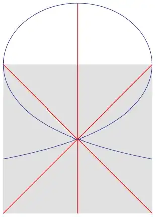

To avoid some fractions, I'll define $b := a/2$, so that the side of the square is $2b$ and its diagonal has length $2b\sqrt{2}$. Position the square so that its bottom lies on the $x$-axis, and its center lies on the $y$ axis (specifically, at $(0,b)$).
A tilted diagonal determines a line through $(0,b)$ and, say, $(c,0)$, with $c$ some parameter such that $-b \leq c \leq b$. Such a line has equation $$\frac{x}{c} + \frac{y}{b} = 1 \qquad \to \qquad x b + y c = b c \qquad (\star)$$ The upper endpoint, $(x,y)$, of the tilted diagonal is a distance $2b\sqrt{2}$ from $(c,0)$: $$(x-c)^2 + y^2 = 8 b^2 \qquad (\star\star)$$ Eliminating $c$ from $(\star)$ and $(\star\star)$ gives $$x^2 = \frac{(y-b)^2 (8 b^2 - y^2)}{y^2}$$ This equation represents this graph:
The area of the portion above the square can be determined via this integral:
$$2\;\int_{2b}^{2b\sqrt{2}}\frac{y-b}{y}\sqrt{8b^2-y^2} \; dy = 2b^2 \left( \pi - 2 \sqrt{2} \log( 1 + \sqrt{2} ) \right) = a^2 \left( \frac{\pi}{2} - \sqrt{2} \log(1+\sqrt{2})\right)$$ which agrees with both @OmranKouba and @IanMateus.
Blue

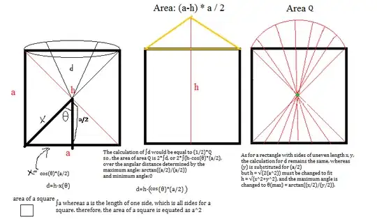

I'm not like super expert at math, and I only kind of checked my work, but I'm pretty sure this crudely-drawn msPaint picture is correct.
    I'm gonna be honest, the fact that you thought this was posting after all the other awesome answers (and with that ridiculous disclaimer, no less!) is hilarious. I mean, kudos on getting an answer that agrees with Omran Kouba's, but...really? – Kyle Strand Apr 07 '14 at 18:45
(Misinterpreted question, working on the correct version), the second part still holds.
