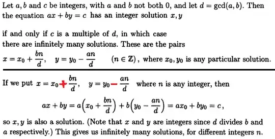

(1) Can't the signs - I colored them in red - of x and y be switched? Aren't $x = x_0 - bn/d$ and $y = y_0 + an/d$ also solutions? They satisfy $ax + by = c$?
(2) How can I remember these general solutions? Where did $x,y$ hail from? Jones didn't delineate how he found them?
Origin - Elementary Number Theory, Jones, p10, Theorem 1.8.
The sentence starting with 'These are the pairs' is p13, Theorem 1.13
