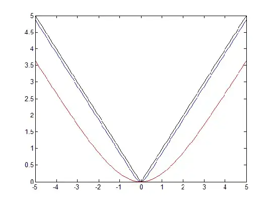

A bit late to the party, but you can smoothly approximate $f(x) = |x|$ by observing $\partial f/\partial x = \mbox{sgn}(x)$ for $x \neq 0$. Therefore approximating the $\mbox{sgn}(x)$ function by
$$ f(x) = 2\mbox{ sigmoid}(kx)-1$$
(the $k$ being a parameter that allows you to control the smoothness), we get
$$ \partial f/\partial x = 2\left (\frac{e^{kx}}{1+e^{kx}} \right ) - 1 $$ $$ \Rightarrow f(x) = \frac{2}{k}\log(1+e^{kx})-x-\frac{2}{k}\log(2)$$
where the constant term was chosen to ensure $f(0) = 0 $.
Included are plots of the function for $x \in [-5,5]$, where $k=1$ is red, $k=10$ is blue and $k=100$ is black.
Note that if you wanted to use the more smooth $k=1$ in the interval $[-5,5]$ it may be worth applying a further linear transformation i.e. ~$5f(x)/3.6$ to ensure the values at the edge of the interval are correct.
