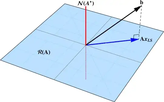

**Trivial solution only **
There is only a trivial solution when $b \in\mathcal{N}(\mathbf{A}^{*})$.
In essence, the method of least squares find the projection of the data vector $b$ onto $\mathcal{R}(\mathbf{A})$. When the data vector lives in the null space, there is no projection onto the range.
$$ \begin{align} \mathbf{A} x & = b \\ \left[ \begin{array}{cc} 1 & 0 \\ 0 & 1 \\ 0 & 0 \end{array} \right] \left[ \begin{array}{c} x_{1} \\ x_{2} \\ \end{array} \right] &= \left[ \begin{array}{c} 0 \\ 0 \\ 1 \end{array} \right] \end{align} $$
- 10,768
Please, could you tell me how you generated that image? I really like the shadows. – Guillermo Mosse May 29 '18 at 19:29
@Guillermo Mosse: send an email (see profile) and I can send the script. – dantopa May 30 '18 at 22:04
Don't you think the projection still exists in your case and it's just $\overrightarrow{0}$? So, in this case you're just solving the homogeneous system $Ax = 0$. And a homogeneous linear system always has a solution: $x =0$. Does it matter if the solution is trivial? – Agustí Roig Jan 07 '19 at 21:21
@d.t.: This is a confusing point; thanks for providing a sharp question. (1) By convention, 0 solutions are excluded to prevent the tedium of adding "+0" to every linear system solution. (2) Perhaps this example will help: Addendum: Existence of the Least Squares Solution. – dantopa Jan 09 '19 at 00:26
@dantopa I think there is no confusion at all. If you look into any linear algebra book, and check the definition of orthogonal projection, you'll see that, in case your vector $b$ projects to the zero vector..., well it projects to the zero vector: $\overrightarrow{0}$ is a legit vector in every vector space. Also, there is no such convention to exclude $\overrightarrow{0}$ as a legit solution of a system of linear equations. Not in any linear algebra book I am aware of, and I know quite a few. But I would appreciate very much that you can find such a book with such a convention. – Agustí Roig Jan 09 '19 at 15:06
