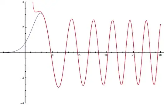

Naively applying the saddle point method to this integral indicates that, for large $a$,
$$ \begin{align} K_{ia}(2\pi) &\approx \frac{e^{-a\pi/2} \sqrt{\pi}}{(a^2-4\pi^2)^{1/4}} \Bigl( \sin f(a) + \cos f(a) \Bigr) \\ &=\frac{e^{-a\pi/2} \sqrt{2\pi}}{(a^2-4\pi^2)^{1/4}} \cos\left( f(a) - \frac{\pi}{4} \right), \end{align} $$
where
$$ f(a) = \frac{a}{2} \log\left(\frac{a^2-2\pi^2+a\sqrt{a^2-4\pi^2}}{2\pi^2}\right) - \sqrt{a^2-4\pi^2}. $$
Here's a plot of $K_{ia}(2\pi)$ in blue versus this approximation in red (both scaled by a factor of $e^{a\pi/2}\sqrt{a}$ as in Raymond's graph).
The approximation has zeros whenever

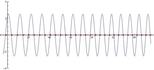

$$ f(a) = \frac{3\pi}{4} + n\pi, \tag{$*$} $$
and since
$$ f(a) \approx a\log(a/\pi) - a $$
for large $a$ we expect that solutions of $(*)$ for large $n$ satisfy
$$ a \approx \frac{3\pi/4+n\pi}{W\Bigl((3\pi/4+n\pi)/e\Bigr)}, $$
where $W$ is the Lambert W function.
Here's a plot of $e^{a\pi/2} \sqrt{a} K_{ia}(2\pi)$ in blue with these approximate zeros in red.

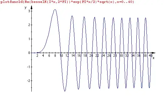

I used the free pari/gp $(*)$ to get the smallest positive solutions : \begin{array} {l} 9.76877008350997786701461088004548816694073504626\\ 12.4484878927757792253076746584484174280206806290\\ 14.6849597759503320940392747073070219296666773881\\ 16.6915789382924172031614835847470262244558902255\\ 18.5493751970112696445359821473043722645995430537\\ 20.2999030639074716000431186500336768257041209063\\ 21.9679863621154849828379155738628510793020013525\\ 23.5699217186674186162756939876181463960995601839\\ 25.1171217228471128822167760437525949613439934666\\ 26.6179647161774511589115811996122442026801440680\\ 28.0788271377389792376836682977823877359218232495\\ 29.5047018750550818302335792765863272958843396063\\ \end{array}
These solutions are much more regular than the zeta zeros as you may appreciate in this plot of $\;\displaystyle x\mapsto \operatorname{K}_{ix}(2\pi)\;e^{\pi\,x/2}\sqrt{x}\;$ (the oscillations became quickly very small thus the 'rescaling') :
K_ix(2 pi)
