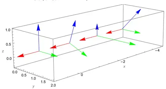

A linear map can be identified by knowing how it acts on the basis elements of your vector space. Let $\color{red}{\vec e_1}=(1,0,0)^T,\quad\color{green}{\vec e_2}=(0,1,0)^T,\quad\color{blue}{\vec e_3}=(0,0,1)^T$. A linear map $M$ is then uniquely specified by the three vectors that are the result of applying $M$ to the basis vectors, i.e. \begin{align} \color{red}{\vec m_1}&=M\color{red}{\vec e_1}\\ \color{green}{\vec m_2}&=M\color{green}{\vec e_2}\\ \color{blue}{\vec m_3}&=M\color{blue}{\vec e_3} \end{align} In fact, these vectors can be easily found if we write this linear map in matrix form: \begin{align} M=\left( \begin{array}{ccc} \color{red}{M_{1,1}} & \color{green}{M_{1,2}} & \color{blue}{M_{1,3}} \\ \color{red}{M_{2,1}} & \color{green}{M_{2,2}} & \color{blue}{M_{2,3}} \\ \color{red}{M_{3,1}} & \color{green}{M_{3,2}} & \color{blue}{M_{3,3}} \\ \end{array} \right)=\begin{pmatrix}\color{red}{\vec m_1}&\color{green}{\vec m_2}&\color{blue}{\vec m_3}\end{pmatrix} \end{align} We can plot three 3D vectors just fine. Can you tell which matrices I plotted in the picture below? An alternative to plotting 3 arrows is to plot an object like a cube subject to the transformation. A cube is very symmetric so when you do this you have to color code each face or otherwise use a less symmetric object to be able to distinguish reflections.
As a sidenote: for the moment of inertia tensor this picture might not tell too much. Maybe it would be nice if you could a show cube with the same moment of inertia as the object you are interested in.
I used the following Mathematica code to generate these:
plotmatrix[M_, pos_ : {0, 0, 0}] := {
  Red, Arrow[{pos, pos + M[[1]]}],
  Green, Arrow[{pos, pos + M[[2]]}],
  Blue, Arrow[{pos, pos + M[[3]]}]
offset = 1.5 {-1, 0, 0};
Graphics3D[{
  plotmatrix[T, offset*0],
  plotmatrix[RotationMatrix[20 Degree, {1, 0, 0}], offset*1],
  plotmatrix[DiagonalMatrix[{1, 2, .5}], offset*2],
  plotmatrix[{{1, 0, 0}, {0, 1, 0}, {0, 1, 1}}, offset*3]
 AxesLabel -> {x, y, z}, Axes -> True]
