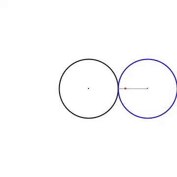

Your border case corresponds to $h=\frac12$. Interpreted from the epitrochoid viewpoint, this means that the tracing point is halfway between the circumference and the center of the rolling circle:
"flat" limaçon as a roulette

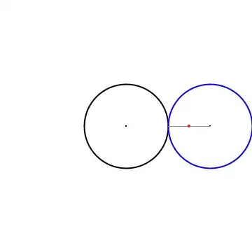

For $0 < h < \frac12$, the tracing point is near the center of the rolling circle, and thus the limaçon can be expected to be convex (with the extreme $h=0$ case giving the circle whose radius is twice the original). For $h > \frac12$, the tracing point "juts out" a bit, and thus we see the dimples in the limaçon:
dimpled limaçon as a roulette

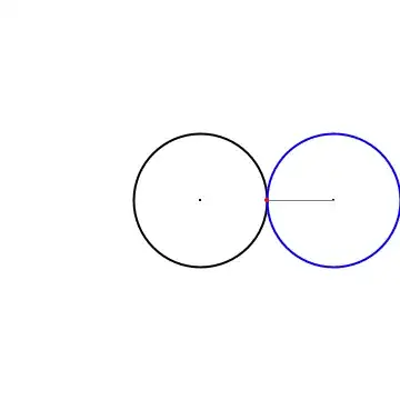

For the cardioid case ($h=1$) in particular, the cusp corresponds to where the tracing point coincides with the point of contact of the fixed and rolling circles:

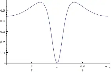

Somewhat related to Robert's and Rahul's answers: it might be more illustrative to consider the curvature of the limaçon. Without loss of generality, consider the case $b=1$ and positive $a$ (all other cases are related by scaling and reflection about the horizontal axis). The curvature function is
$$\frac{a^2+3a\cos\,\theta+2}{\sqrt{(a^2+2a\cos\,\theta+1)^3}}$$
For $a=2$ (your boundary), a plot of the curvature function shows that its only zero is at $\theta=\pi$, and that point is a tangency point:
limaçon curvature, a=2
(Remember that a point of zero curvature corresponds to your curve being "locally straight").
For $a > 2$ or for $a < 1$, the curvature function is entirely positive (no "straight sections"). The cardioid case, $a=1$, yields a curvature function that is singular at $\theta=\pi$ (corresponding to the cusp). Finally, for the case $1 < a < 2$, the curvature becomes zero at the points $\theta=\arccos\dfrac{-a^2-2}{3a}$ and $\theta=2\pi-\arccos\dfrac{-a^2-2}{3a}$, which exactly corresponds to the case where one starts to see dimples...
