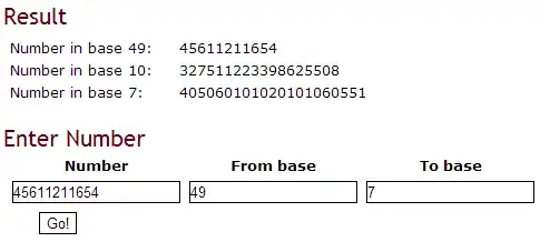

Counter-example (for part 1) : $$45611211654_{49} = 405060101020101060551_{7}$$

  • This is not a counter example for 2 reasons. First, $7497_{16}$ is not a palindrome (this is the assumption I make) and second, 7,4,9,7 are all greater than or equal to 2. I appreciate the effort though. – David P Mar 10 '14 at 20:51
  • oh sorry...I understood that if $N_p$ was a palindrome, then $N_{p^n}$ was a palindrome too... – sirfoga Mar 10 '14 at 20:59
  • If you look at my counter-example to divisibility, $2002001001_4$ is similar to your counter-example as it is a palindrome in base 2. So yes, it is not an if-and-only-if. – David P Mar 10 '14 at 21:00
  • @David Peterson I've edited the answer with a "real" counterexample... – sirfoga Mar 11 '14 at 15:46
  • regarding your new counter-example, those can't be the same. Modulo 7 the left-hand side is equal to 4, the right-hand-side is equal to 1. – David P Mar 11 '14 at 18:31
  • I've doublechecked it in many online base transformation sites... – sirfoga Mar 11 '14 at 18:33
  • check it yourself!..http://korn19.ch/coding/base_converter.php – sirfoga Mar 11 '14 at 18:34
  • The calculator is incorrect... If a=b then a (mod n) == b(mod n). But for your benefit here are the actual decimal values of each. The left-hand side is http://goo.gl/OvM908, the right-hand side is http://goo.gl/SDLgNc – David P Mar 11 '14 at 18:40
  • sorry...poor me who trusted an online calculator :( – sirfoga Mar 11 '14 at 18:50
