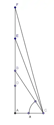

If you solve expression for $n$ you get
$n=\sqrt{c^2-a^2}-a$, let's denote $b=\sqrt{c^2-a^2}$,so we have that $n=b-a$
Now,take look at picture bellow.Note that $AD=a$,and $BD=b-a=n$
If you change value of $b$ and keep $a$ to be constant you will get a infinite number of right triangles,and therefore infinite number of values of $n=b-a$,so answer is yes, there are infinitely many primes $n$ for which equation is solvable.
Pedja
  • 13,292
    Except that you don't know for which integer values of $b$ yield integer values of $c$. – Thomas Andrews Oct 07 '11 at 14:57
  • @Thomas,That's true,I have answered only on second part of the question...however, one can find one (a,b,n) triple and then for each different triple choose another b such that n becomes prime number – Pedja Oct 07 '11 at 15:18
    So, what does your argument say when $n=3$? – Thomas Andrews Oct 07 '11 at 15:33
  • @Thomas,I didn't say that this reasoning is correct for each prime number.I just pointed that there is infinitely many distinct (a,b,n) triples such that n is prime... – Pedja Oct 07 '11 at 15:48
