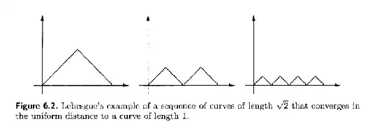

This example was mentioned in a related question. I am adding it to this answer as well, just for the sake of completeness.
It is from the book Mathematical analysis: linear and metric structures and continuity by Mariano Giaquinta, Giuseppe Modica, p.204.
I hope it qualifies as fair use if I copy their picture.
This example shows that length is not upper semicontinuous.
