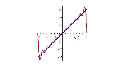

  2. Plots of $f(x)=x$ (blue) and of the partial sum $\sum_{n=1}^{10 }\frac{-2}{n}\cos n\pi \sin nx$ (red) for $-\pi \lt x\lt\pi .$ The Fourier series converges to a periodic function $g(x)$, whose restriction to $]-\pi,\pi[$ coincides with $f(x)=x$. The period of $g(x)$ is $2\pi$ and it has jumps at $x=\pi+2m\pi$, where $m\in\mathbb{Z}$. At these jumps the Fourier series converges to $\frac{g(x^{-})+g(x^+)}{2}=0$. At the point $x=\frac{\pi }{2}$ used below we thus have $g(\pi/2)=f(\pi/2)=\pi/2$. enter image description here
