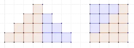

How do I understand it intuitively? It doesn't really make sense to me that the sum of odd numbers up to $2x+1$ should equal $x^2$
Hope this picture will provide you with the visual aid you need. :-)
Lucian
