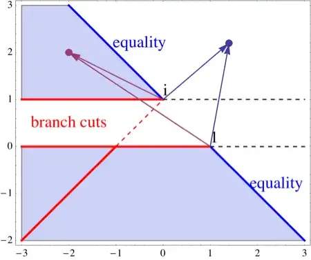

If you simply interpret what it means to say that $\arg(z-1)<\arg(z-i)$ geometrically, then it shouldn't be too hard to visualize the region. In each of the regions below, the argument of the point ($z$) minus the number (either $1$ or $i$) simply the angle from the dashed line to the arrow. It's easy to see that this angle is smaller from the complex number $1$ in exactly the blue regions.
Note that I'm assuming a branch cut at $\pi$ in the argument function so that, in the horizontal strip, $\arg(z-1)$ is definitely negative while $\arg(z-i)$ is positive.

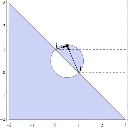

Edit
As can easily be plotted on WolframAlpha, this region looks like so:
Unfortunately, the arguments can easily be read off of the image as the angles between the vectors and the dashed lines. It certainly appears that $\arg(z-1)>\arg(z-i)$ for certain points in the region.
