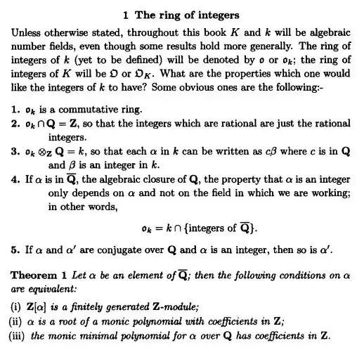

Here is how Swinnerton-Dyer motivated the modern definition of integer:
$\hskip 0.6in$ integers
In order to repair the failure of unique factorization in domains above $\Bbb Z$, which was historically a major motivating factor for the development of classical algebraic number theory, it was seen that integrality was an important feature to have in the transition to ideals.
In particular for squarefree $D\equiv1$ mod $4$ the number ring $\Bbb Z[\sqrt{D}]$ is "missing" $\frac{1+\sqrt{D}}{2}\in{\cal O}_{\Bbb Q(\sqrt{D})}$, which leads to an ideal that fails to admit a unique factorization into ideals, via $(2,1+\sqrt{D})$.

Here is one way to motivate the notion of an algebraic integer. Suppose that we desire to consider as "integers" some subring $\,\mathbb I\,$ of the field of all algebraic numbers. To be a purely algebraic notion, it cannot distinguish between conjugate roots, so if $\rm\,\alpha,\alpha'\,$ are roots of the same polynomial irreducible over $\rm\,\mathbb Q,\,$ then $\rm\,\alpha\in\mathbb I\iff \alpha'\in\mathbb I\,.\,$ Also we desire that $\rm\,\mathbb I\cap \mathbb Q = \mathbb Z,\,$ equivalently $\,m\mid n\,\ {\rm in} \,\ \Bbb I\iff m\mid n\,\ {\rm in}\ \,\Bbb Z,\,$ so that our notion of algebraic integer is a faithful extension of the notion of a rational integer. Now suppose that $\rm\,f(x)\,$ is the monic minimal polynomial over $\rm\,\mathbb Q\,$ of an algebraic "integer" $\rm\,\alpha\in \mathbb I.\,$ Then $\rm\,f(x) = (x-\alpha)\,(x-\alpha')\,(x-\alpha'')\,\cdots\,$ has coef's in $\rm\,\mathbb I\cap \mathbb Q = \mathbb Z.\,$ Thus the monic minimal polynomial of elements $\in\mathbb I\,$ must have coef's $\in\mathbb Z\,.\,$ Conversely, one easily shows that the set of all such algebraic numbers contains $1$ and is closed under both difference and multiplication, so it forms a ring. Further, the quotient field of $\rm\,\mathbb I\,$ is the field of all algebraic numbers. Hence a few natural hypotheses on the notion of an algebraic integer imply the standard criterion in terms of minimal polynomials.
