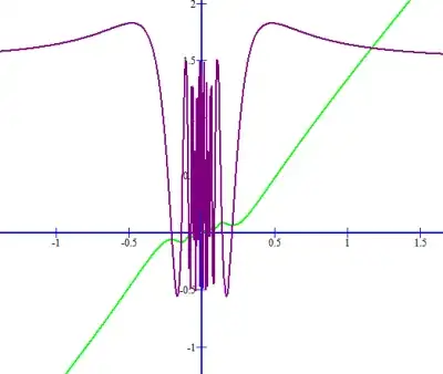

f is differentiable everywhere, including $x = 0$.
To prove $f'(x)$ takes on negative values..., compute $f'(x) = \dfrac{1}{2} + 2x\sin\dfrac{1}{x} - \cos \dfrac{1}{x}$.
3. How does $x(k)$ 'enter'?
4. Why will $g'(x_k) \in (-d, d)$ for k large enough?

  2. It is part of a known set of counterexamples in analysis/topology. They are (loosely speaking) collected under the umbrella term of Topologist's sine curve. At the heart is the function $h(x)=\sin(1/x)$ that has no limit (finite or infinite) as $x\to0$. Then the slightly modified function, $r(x)=xh(x), r(0)=0,$ does have a limit at $x=0$, and is continuous there. But it has no derivative there, because the difference quotient $(r(0+h)-r(0))/h$ oscillates violently between $\pm1$ as $h\to0$. Continuing along the same lines, the function $s(x)=x^2\sin(1/x),s(0)=0,$ behaves better still, and is differentiable at $x=0$. For the purposes of this counterexample, an extra term $x/2$ is needed. As the violently oscillating term $\in[-1,1]$ it is essential that the additional term has slope $1/2$, so that oscillations force sign changes.
