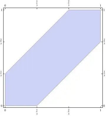

Working in hours and letting 8:00 a.m. be t=0, each mathematician's arrival time is a number between 0 and 1. The sample space can be represented by the unit square in the coordinate plane with one professor's arrival time as x and the other's as y, where regions with equal areas are equally likely. We want x - 1/3 < y < x + 1/3 -- that is, the second professor arrives earlier than the first by no more than 1/3 of an hour or later than the first by no more than 1/3 of an hour.
plot of the inequalities
The area of the desired region is 5/9.

    This is a rather elegant answers =) I do find graphical proofs and solutions rather captivating because (in my mind) because they seem so much more...universal. – Justin L. Jul 25 '10 at 07:42
  • Nice. It's funny we both used Mathematica and then uploaded to imgur for the region plot. – Sophie Alpert Jul 25 '10 at 15:44
  • @Ben: No coincidence there--I liked the way it looked in your answer to my question and I'd been looking for a quick-and-easy image host for images in my answers here, so checked where you'd put that image up. – Isaac Jul 25 '10 at 15:56
  • These images are phenomenal. I am going to figure out what you guys are doing and then do the same for future questions/answers. Thanks! – Tom Stephens Jul 25 '10 at 18:27
    Tom Stephens: In Mathematica, you can generate the above plot by running RegionPlot[x - 1/3 < y < x + 1/3, {x, 0, 1}, {y, 0, 1}, FrameTicks -> {{0, 1/3, 2/3, 1}, {0, 1/3, 2/3, 1}}] then selecting Save Graphic As… from the right-click menu to make a PNG. If you don't have Mathematica, you'll need to find some other tool. – Sophie Alpert Jul 25 '10 at 21:55
  • @Tom,Ben: Without Mathematica, you can get WolframAlpha to do some graphs like this, but it sometimes takes more fiddling around to figure out how to get Alpha to use its underlying Mathematica engine the way you want. – Isaac Jul 25 '10 at 22:20
