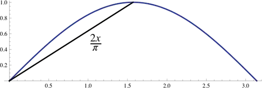

Since $\sin(x)$ is concave on $[0,\pi]$, we have $$ \begin{align} \sin(x) &\ge\sin(0)+(x-0)\frac{\sin(\pi/2)-\sin(0)}{\pi/2-0}\\ &=\frac{2x}{\pi}\\ &\ge\frac x2 \end{align} $$
$\hspace{8mm}$enter image description here
