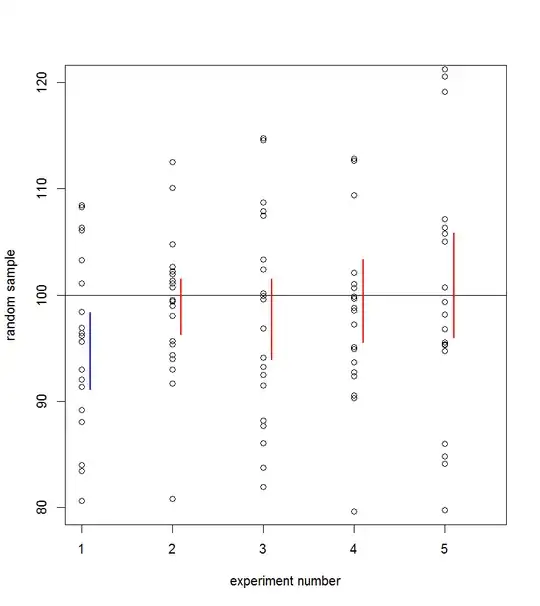

I'm going to concentrate on the concept, the interpretation and misconceptions. I believe all of these can be well addressed by taking an interactive approach. The math I believe should come later after the concepts are established, certainly at an introductory level, and in any case this isn't the place to rehearse all the maths required to explain confidence intervals.
Essentially what I think you can do is find a large population (or large sample) of data, randomly sample from it and produce a confidence interval. If you can't find such a sample, just simulate it. That's what I've done below, simulating taking samples of size 20 and constructing 90% confidence intervals from a normal distribution with mean 100 and standard deviation 10.
After 5 experiments I got this
You can see the first, blue confidence interval doesn't contain the mean, but the rest do. So I was "unlucky" the first time, and "lucky" the remaining times. With a simple approach such as this you can discuss things like
  • concept: producing a confidence interval is like running an experiment. If you repeat the experiment enough then a p% confidence interval will contain the mean p% of the time.
  • interpretation: the higher the confidence interval, the more plausible it is that the true mean is contained within the interval. But if you reject the hypothesis that the true mean is within the interval, you will be wrong (100-p)% if the time.
  • misconceptions: one misconception is that given a confidence interval there's a 95% chance that the given confidence interval contains the true mean. That's false, as you can see with the picture above: for all the confidence intervals shown the confidence intervals contain the mean with 0 and 1 probability. The mean is fixed, and when you run your experiment and sample data, there's a 95% chance that you'll sample "good" data that contains the mean.
Other than that, an interactive approach is good because it means you can ask questions like
  • does the interval get smaller or larger if you increase the confidence level?
  • what happens if you increase the sample size?
  • (advanced) what happens if you change the underlying distribution from which you sample?
