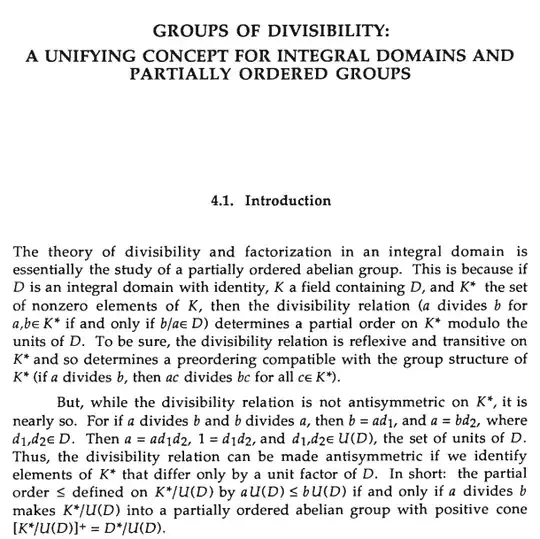

For more on divisibility groups see the following surveys:
J.L. Mott, Groups of divisibility: A unifying concept for integral domains and partially ordered groups, Mathematics and its Applications, no. 48, 1989, pp. 80-104.
J.L. Mott, The group of divisibility and its applications, Conference on Commutative Algebra (Univ. Kansas, Lawrence, Kan., 1972), Springer, Berlin, 1973, pp. 194-208. Lecture Notes in Math., Vol. 311. MR 49 #2712

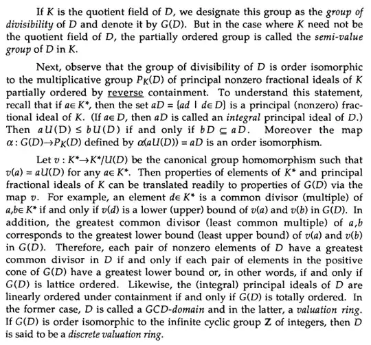

  • @BillDubuque: Regarding the first bullet point, about UFDs: won't G(R), as an abstract group, be a sum of copies of $\mathbb{Z}$ for any Dedekind domain, for instance? Perhaps the statement holds once you introduce an appropriate partial order though? – ndkrempel May 08 '22 at 18:37
  • @ndkrempel I appended an excerpt which gives more detail (too long for a comment). – Bill Dubuque May 08 '22 at 19:34
