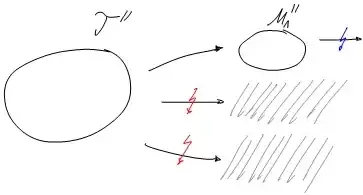

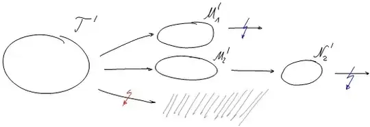

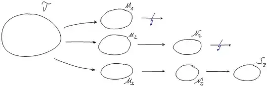

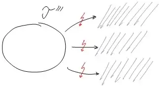

...I would always like to start from some given topology:
Topology A
Topology B
Topology C
Topology D
